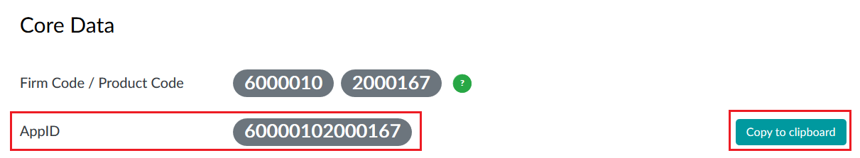

"identifier":
An unique app identifier assigned by the PLCnext Store on app creation (the combination of Firm Code / Product Code). It is going to be used for creating unique folder names, which will be marked with <App Identifier> throug­hout this guide.
The app identifier must consist of 14 numbers in string format.

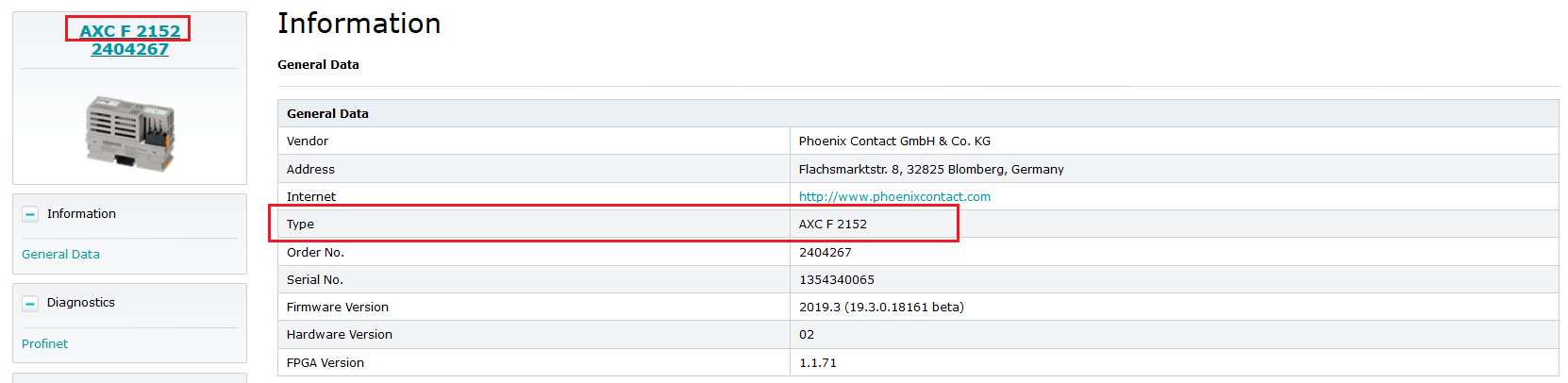

"target":
the controller this app is intended to run on. To be recognized automatically this string has to be identical to the representation in the WBM of the controller under Information → Type. The target may contain:
  • a single target entry:
    • e.g. "target": "AXC F 2152"
    • supported in all PLCnext firmware version from 19.0.0.
  • several entries of supported targets, which are separated from each other by a comma
    • e.g. "target": "AXC F 2152,AXC F 1152"
    • Attention: please enter the target name without any additional characters or spaces.

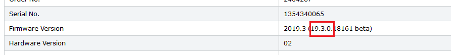

"minfirmware_version":
the minimally required firmware version to run the app in the format <major version>.<minor version>.<fixes> e.g. 19.0.0 for the LTS version of 2019.
