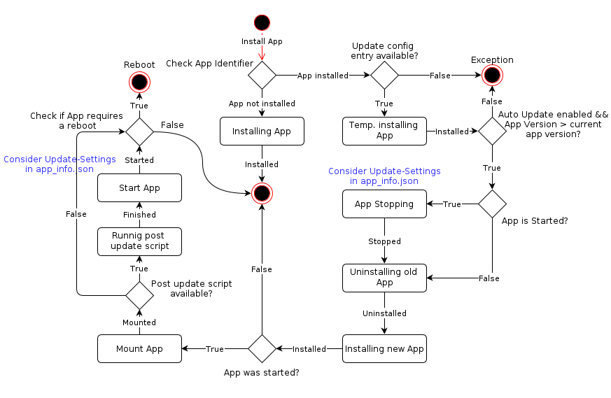

The update process is shown in the following figure:
To update an app you need only to install the app container which contains the new app version (without uninstalling the old app version). The update is detected automatically when:

The following applies on app update:
  • Supported configuration on app update:
    • Keep/Delete temporary/persistent data folder of the app. The temporary/persistent data folders will exist only if the app is running. (See File-/Data-Storage).
  • Run a user specific linux shell script immediately after the update and before starting the app (if it the app was running on update).
  • If a post-update shell script is provided (see Necessary additions in the app description file), it will only be executed if the automatic update mode is present and the app was started (RUN-Mode) at the update time point.
