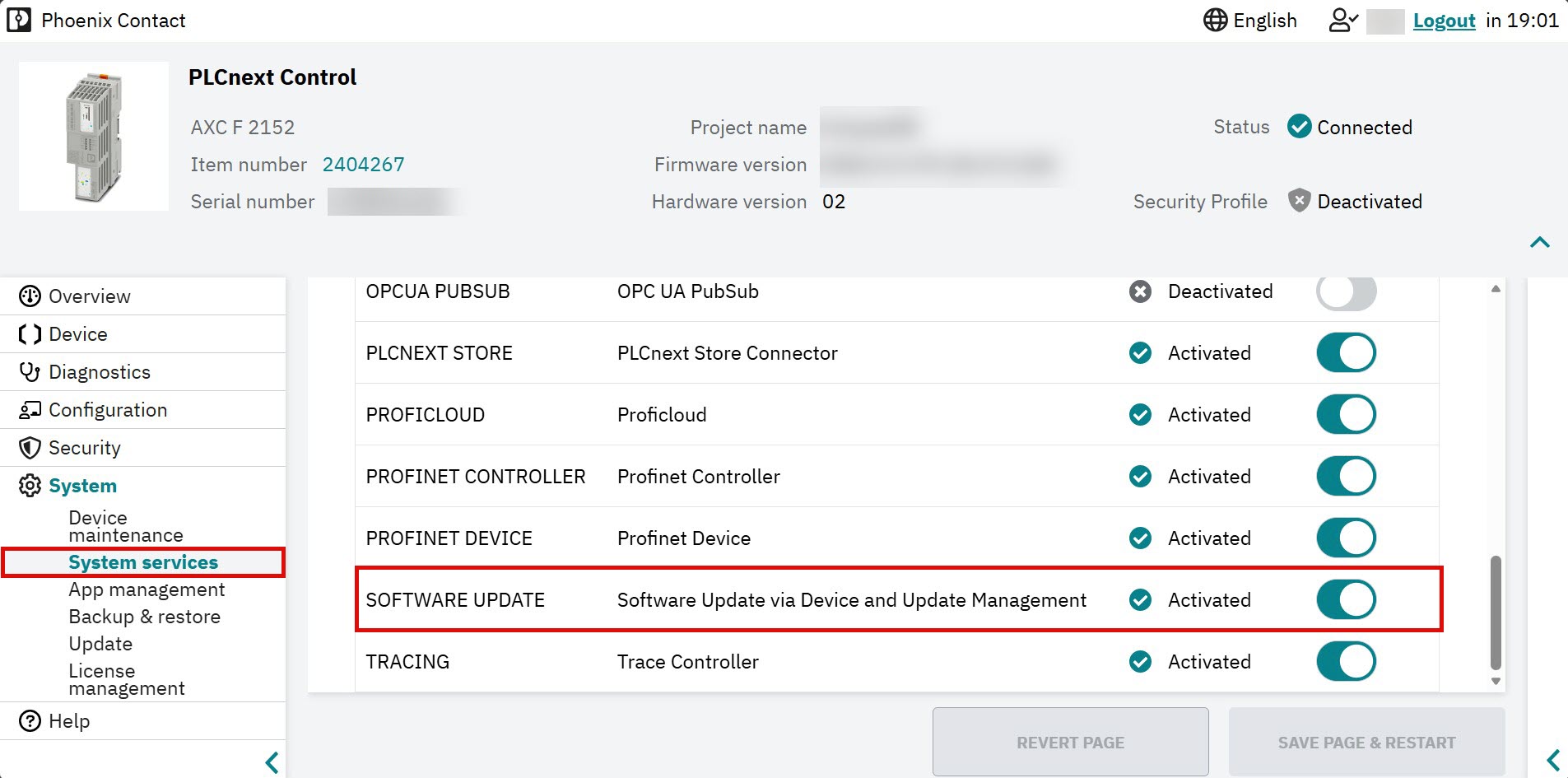

Note: When the software update on the device is not activated, an exclamation mark appears next to the software revision.
  • Activate the SOFTWARE UPDATE system service on the device via the WBM

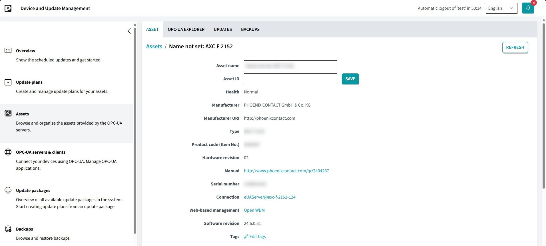

Asset details
If you click on the asset name, the detail page of the respective asset will open.
On the asset details page, you can assign an asset name and the asset ID. Name and asset ID are stored on the device.
Available from DaUM version 2025.6:
The Open WBM link on the asset detail page uses a fixed URL scheme to construct the link. For customer configurations with an intermediate reverse proxy, these URLs may not work. The URLs are editable for each asset:

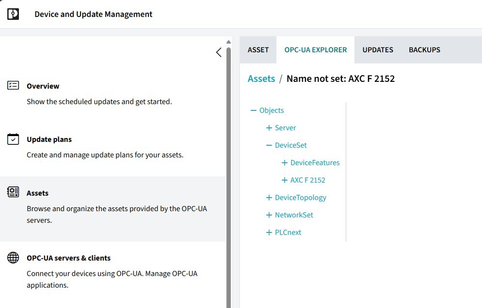

OPC UA® Explorer
The DaUM has an OPC UA® data explorer that is able to read and write OPC UA® variables of an asset. The explorer presents a tree view for the OPC UA® hierarchy with a detail view when selecting a node in the tree. In the detail view, the variable should be editable if not read-only.

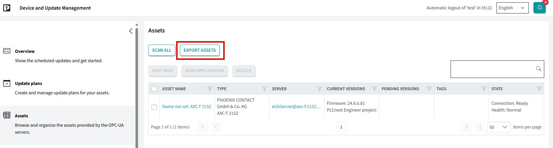

Export assets
You can export the list of assets stored in the  Device and Update Management in CSV format suitable for Microsoft® Excel.
To export a list of assets, proceed as follows:
  • On the overiew page of the assets, click the EXPORT ASSETS button.

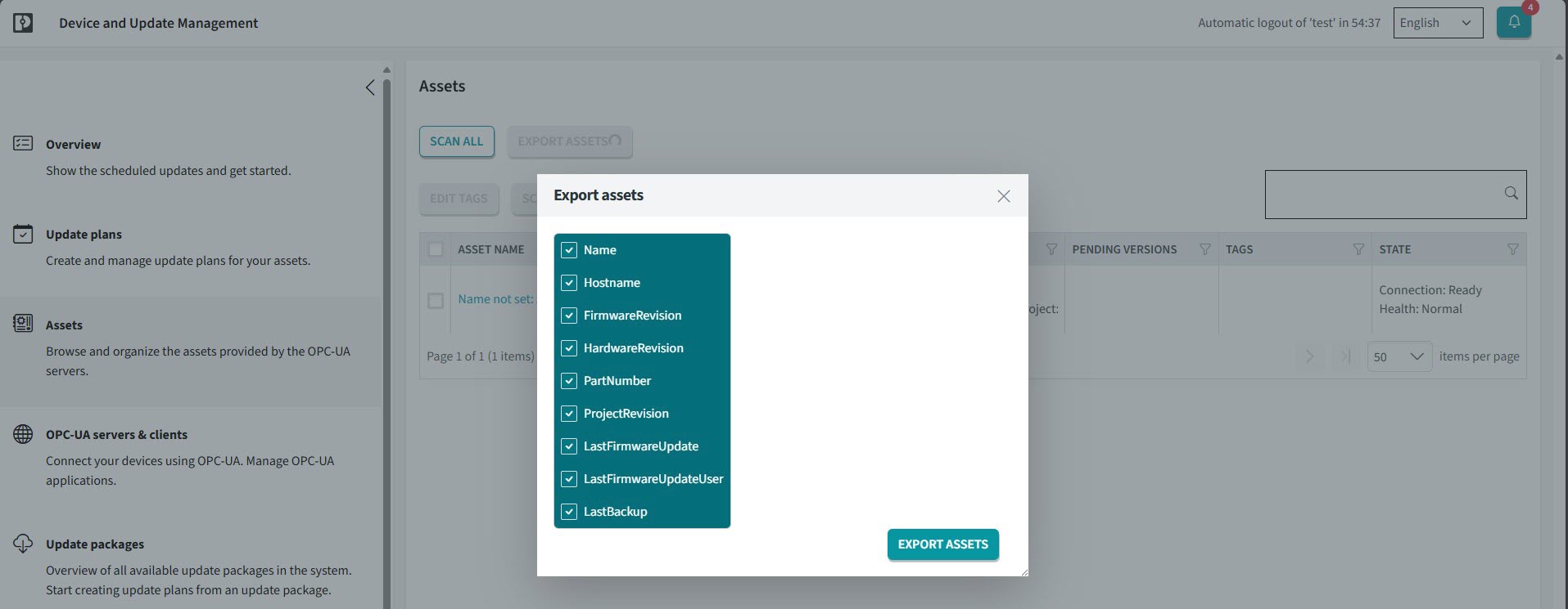

  • Select which data should be included in the export.
  • Click the EXPORT ASSETS button.
Note: You are not able to export sensitive data such as passwords or private keys with this export.
