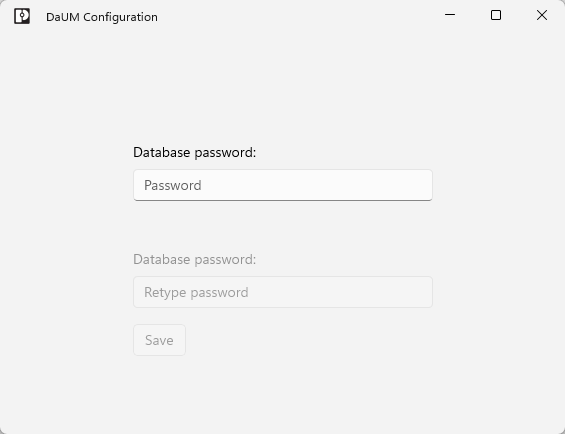

From DaUM version 2026.0:
During new DaUM installations, you must set the master password for the encrypted database. Use a strong, hard-to-guess password which requires high overall complexity, typically achieved with a long passphrase or a random character combination. Keep the password in mind for later use.
