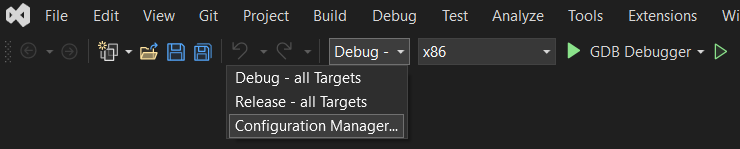

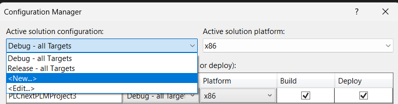

Visual Studio® error "Value does not fall within the expected range."
Known for PLCnext Technology Toolchain from 2024.0:
This issue appears with Visual Studio 2022 version 17.9.2 and newer. A bugfix needs to be found. Meanwhile, use this workaroundthis workaround.
  • Start a project without a target and add a solution configuration manually named Project-specific. After that, it should be possible to add targets to the project and work as usual.
  • Open the configuration manager.
  • Add a new configuration.
  • Name the new configuration Project-specific and uncheck the checkbox Create new project configuration.
