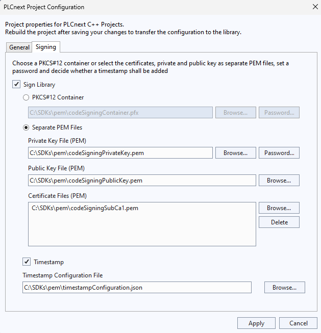

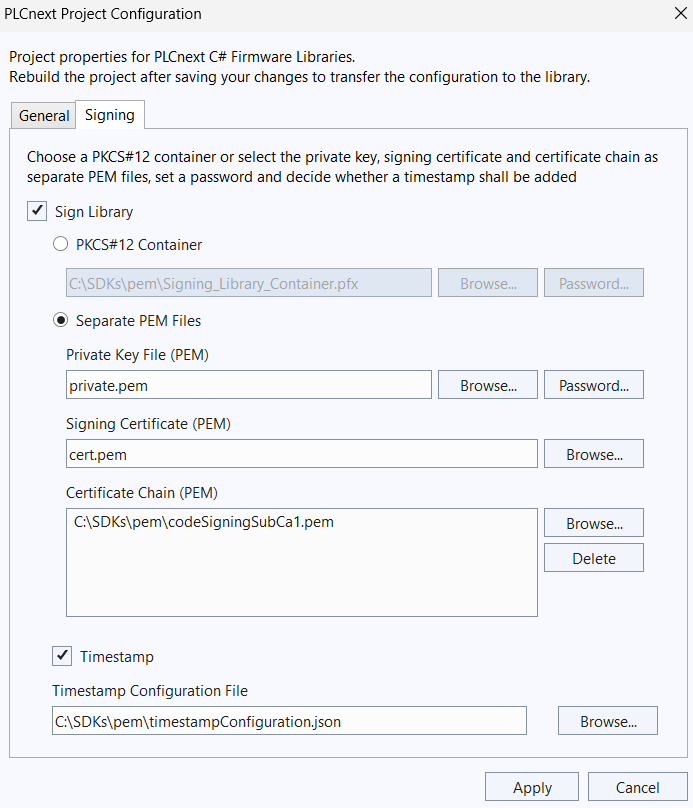

Adding a signature by means of Visual Studio®
  • To configure the signing of a library in Visual Studio®, right click on your project in the Solution Explorer, select PLCnext Technology → Project Configuration.
    Visual Studio signing GUI
  • Switch to the Signing tab and make your choices:
    • Signing can be activated or deactivated; to use a signature with your project, tick the Sign Library mark.
    • There are two options to provide the necessary files:
      • The first option is a PKCS#12 Container, this contains a public and a private key to sign and a (derived) certificate of the issuing certificate authority.
      • The second option is to provide these files in the PEM format file by file.
    • Both the PKCS#12 container or the private key file in PEM format can be protected by a Password....
      This password is stored for the user per project and will be protected by the default Visual Studio® mechanism.
    • The last option is to add a timestamp configuration file for a CAdES-T signature.
Security Note: Always use unique and strictly monotonically increasing version numbers for releases of a library. This can be set in the General tab.

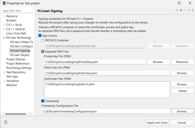

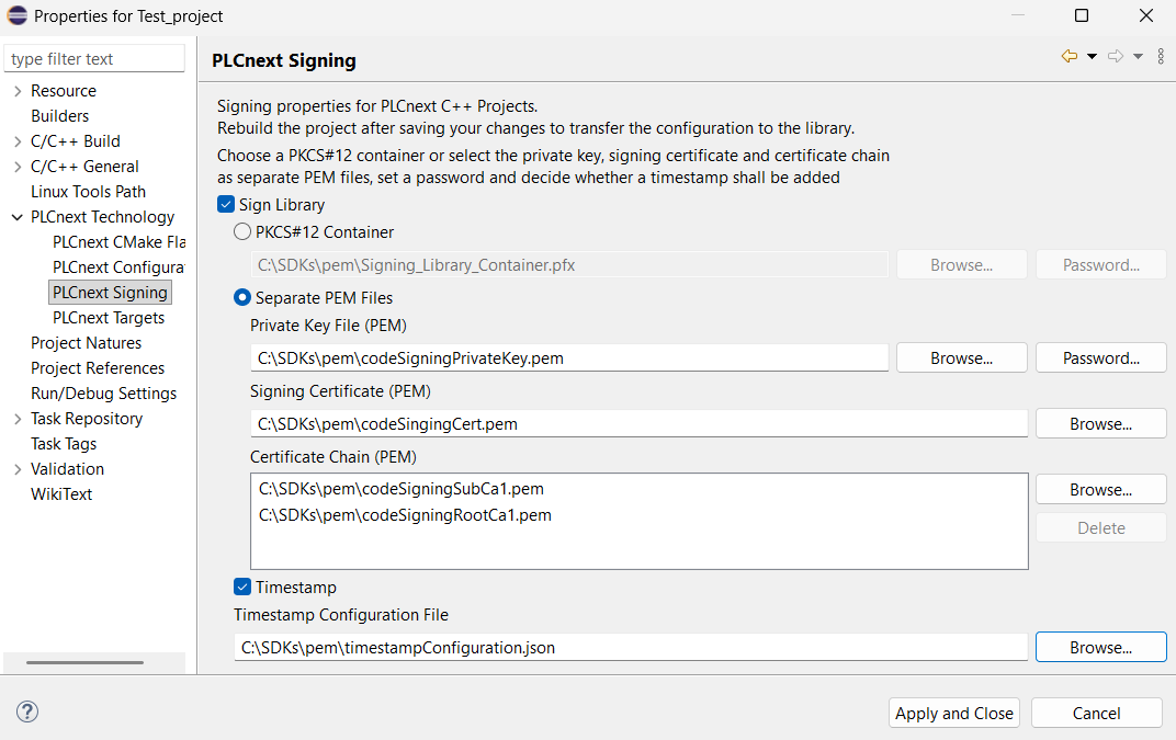

Adding a signature by means of Eclipse®
  • To configure the signing of a library in Eclipse®, open the project properties, select PLCnext Technology → PLCnext Signing.
    Eclipse signing GUI
  • Make your choices:
      • The second option is to provide the separate files in the PEM format.
      This password is stored for the user per project and will be protected by the default Eclipse® mechanism.
    • Another option is to add a timestamp configuration file for a CAdES-T signature.
Security Note: Always use unique and strictly monotonically increasing version numbers for releases of a library. This can be set in the PLCnext Configuration tab.
