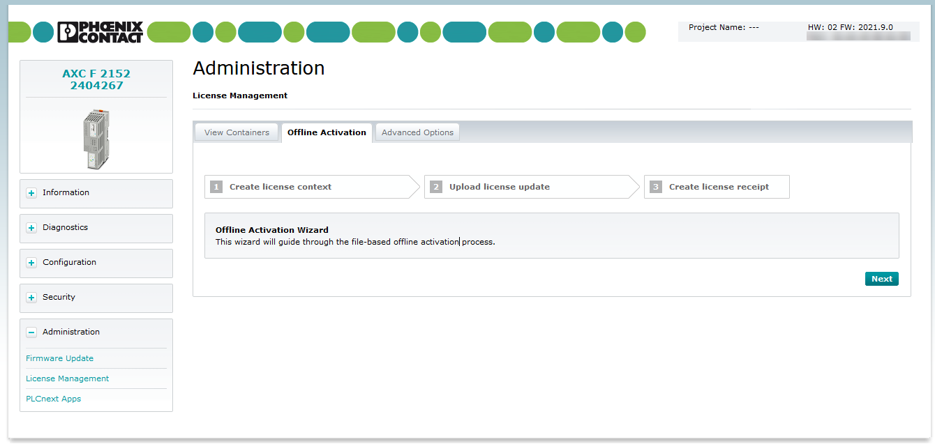

Offline Activation tab
Available from 2020.0 LTS
On the Offline Activation tab, licenses can be activated and deactivated offline with license files provided by the PLCnext Store. The term "offline" in this context means that the PLCnext device which runs the licensed app does not have to be connected to the PLCnext Store during the license activation. This might be necessary if the PLCnext device is located in an area without proper Internet connection, or for preventing security issues.
A description of how to carry out offline licensing can also be found in the topic Offline activation in the PLCnext Store Info Center.
For online license management via the PLCnext Store, see the topics  Installing a license. and Uninstalling a license in the PLCnext Store Info Center.
In the WBM, the Offline Activation Wizard will guide you through the activation process and provides further information.

  1. Performing the Offline Activation step 1: Create license context
    1. If there is a ! No container found. note displayed, create a container directly via the standard procedure:
      1. At the Device  drop-down menu (optional, available from 2021.9), select whether you want to create a license container on the PLCnext device or on the SD card.
      2. Click on Create container.
        ↪ A *.WibuCmRaC or *.PLCnextRaC license context file will be created.
    2. Download the license context file and save it on your PC.
    3. Open the PLCnext Store and log in to your account.
    4. Upload the *.WibuCmRaC or *.PLCnextRaC license context file in the PLCnext Store.
      ↪ The PLCnext Store will generate a *.WibuCmRaU or *.PLCnextRaU (license update) file based on the information from the uploaded license context file.
    5. Download the generated update file and save it on your computer.
  2. Performing the Offline Activation step 2: Upload license update
    1. Click on the Browse... button.
    2. Navigate to the *.WibuCmRaU or *.PLCnextRaU license update file on your computer.
    3. Click Next to upload.
      ↪ A *.WibuCmRaR or *.PLCnextRaR (license receipt) file is generated and provided for download.
