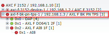

Tree View tab
The Tree View tab provides an overview of the configured PROFINET Devices. The overview contains the device names of the PROFINET Devices, their current IP settings, as well as the diagnostic state of the devices and modules.
Tree View
The PROFINET Tree View contains all the PROFINET Devices from the Device List.
  • Click [+] or [‒] to open or close the next level of the Tree View.
The following icons provide information on the current diagnostic state of the PROFINET Device:
OK     Normal operation state.
Warning     Maintenance is required according to the PROFINET specification.
Urgent Warning     Maintenance is urgently required according to the PROFINET specification.
Error An error has occurred which needs to be resolved immediately.
AR Deactivated AR is deactivated, e.g. via function block AR_MGT in PLCnext Engineer (from firmware 2022.0 LTS).
Module Difference There is a physically another module in the backplane than in the configuration of the project (see Module difference).
No Connection AR could not be established.
No Information In case of a deactivated or not established AR there is no information available of the actual physical configuration in the backplane of the respective PROFINET Device.

Station level
The following information on the PROFINET Devices is available on Station level:
  • Station name
  • IP address
  • Number of connected modules
If you click on the station icon, a Device Information window will open, containing further information. In this example there is power fail of module, visualized by the error code and the corresponding plain text in the Channel Diagnosis section.
If the GSDML (or FDCML) file does not contain a plain text for the corresponding error code, a following message "Manufacturer specific” (3400(hex)) would be displayed.
If the GSDML (or FDCML) file contains a vendor-specific help text in addition to the plain text, that vendor-specific help text will be displayed in the Status Details as in the following example:

Module difference
If there is physically another module in the backplane than in the project configuration, a specific diagnosis is displayed in the WBM.
In this case, the Tree view will display the following:
In case of a wrong module, the Submodule Information view displays the following:
In case a module is configured in PLCnext Engineer but is physically not available in the backplane, the Module Information view displays the following:
With firmware version 2022.6 or newer:
In case a module is configured in PLCnext Engineer but physically a different module is installed, the Module Information view displays Wrong Module and the module ID of the physically installed module:
