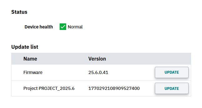

  • In order to check for the firmware update to be successful later, note the currently installed firmware version which is displayed in the Version column of the Update list.
    ↓ Initial state (example) of the Update WBM2 page
  • In the table row showing the current firmware, click the Update button.

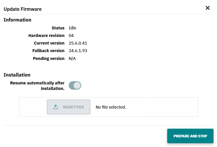

    ↪ The Update Firmware dialog shows; the Status shows Idle, and the current and the fallback version of the firmware are mentioned.
    ↓ Update firmware dialog box
  • Make sure that the device can be stopped; to proceed, click the Prepare and Stop button in the lower-right corner.

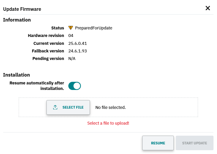

    ↪ The device is prepared for an update and a running application stops; the Status changes to PreparedForUpdate (for details to that state machine see Updating).
    ↪ If you need to cancel the update process from here and get back to the idle state, click the Resume button at the bottom of the dialog.
    ↓ PreparedForUpdate state in the dialog box
  • Click the Select file button, then navigate to the *.raucb file you prepared in the previous step.
    ↪ The selected firmware file name is displayed.

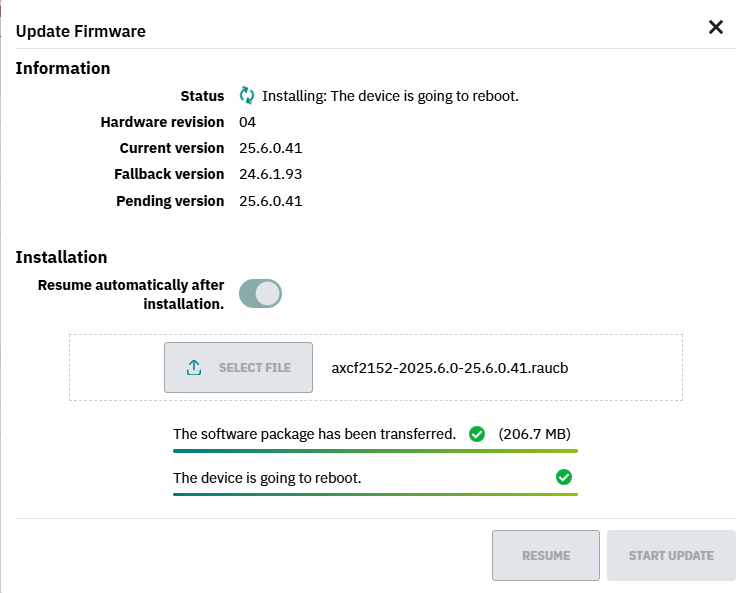

    ↪ The firmware is installed, displaying steps with a progress bar:
    • The software package is first transferred to the device and the proper transfer is evaluated; if successful, the pending version is displayed.
    • The signature is verified.
    • The fallback firmware image is copied to the rootfs file system.
    • The device is rebooting from the updated firmware.
