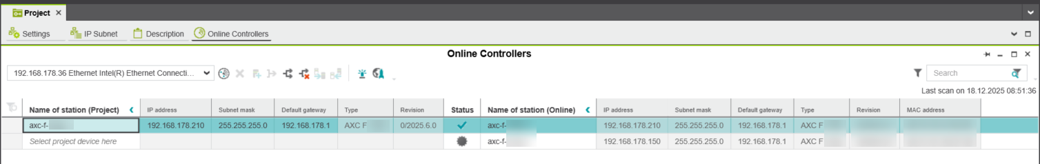

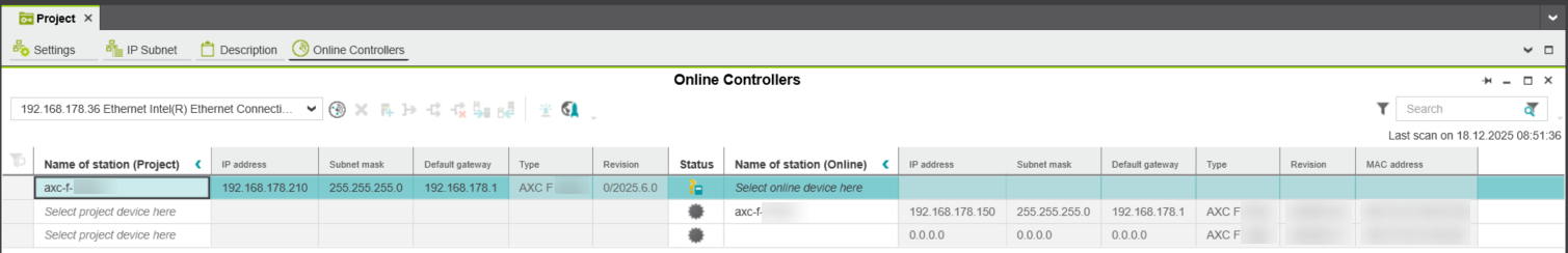

  • Use PLCnext Engineer to set the IP addresses and the device name according to your requirements (in the "Online controllers" area).

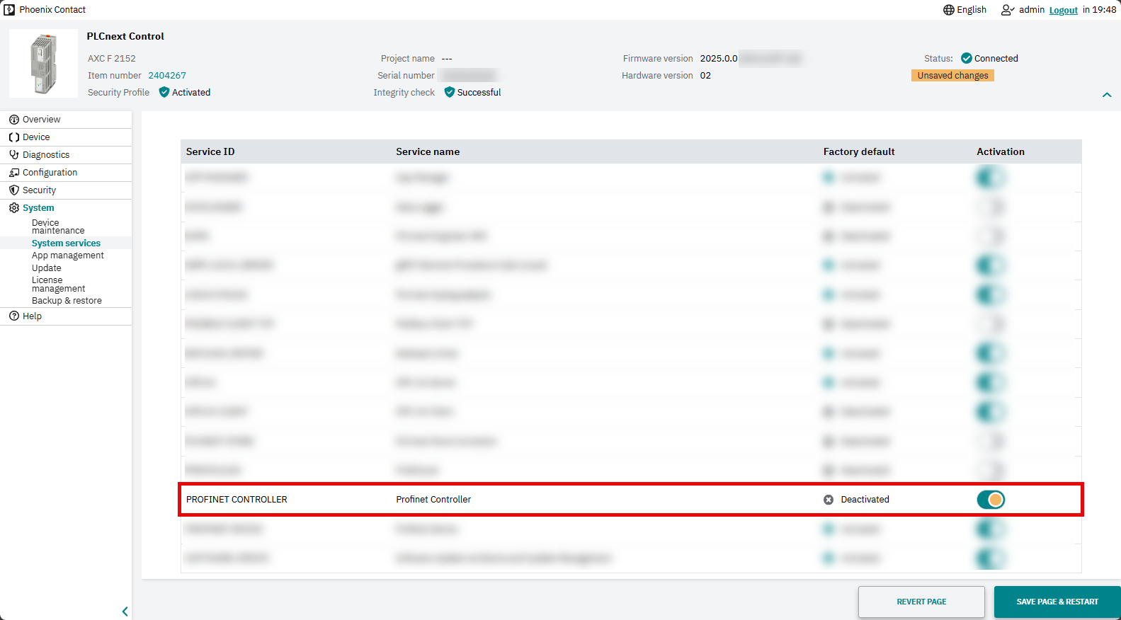

After you have performed a threat analysis and implemented appropriate protective measures from the security context, you can activate the PROFINET Controller. The PROFINET device is activated by default.
Note: If you do not use PROFINET device, you must deactivate it.
  • Log in to the WBM.
  • Open the System services page (SystemSystem services) in the WBM.
  • Activate the toggle switch of the PROFINET Controller.
  • Click the SAVE PAGE & RESTART button.
After the PLCnext Control has rebooted, you must configure the firewall input and output rules. To do this, proceed as follows:

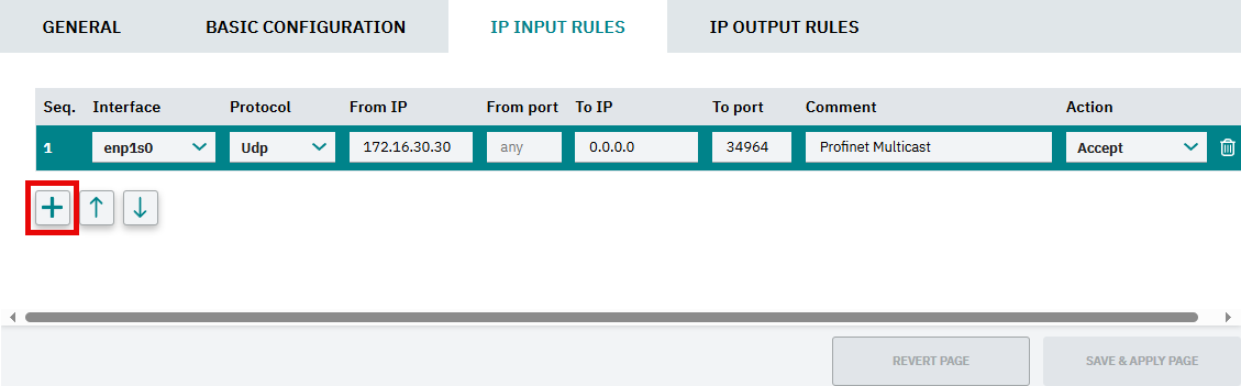

Input rules
Note: To select the correct interfaces, refer to the corresponding PLCnext Control topic (e. g. AXC F 2152).

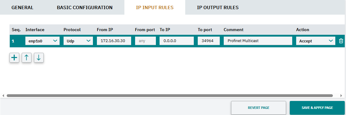

  • Open the Firewall page (SecurityFirewall) in the WBM.
  • Open the IP INPUT RULES tab.
  • Add a new rule via the .
  • Provide the following information:
    • Select the interface (refer to the topic AXC F 2152).
    • Select the protocol.
    • Enter the IP address range (refer to the topic Deriving IP addresses).
    • Enter the target port (here: 34964).
    • Select the action Accept
  • Click the SAVE & APPLY PAGE button.

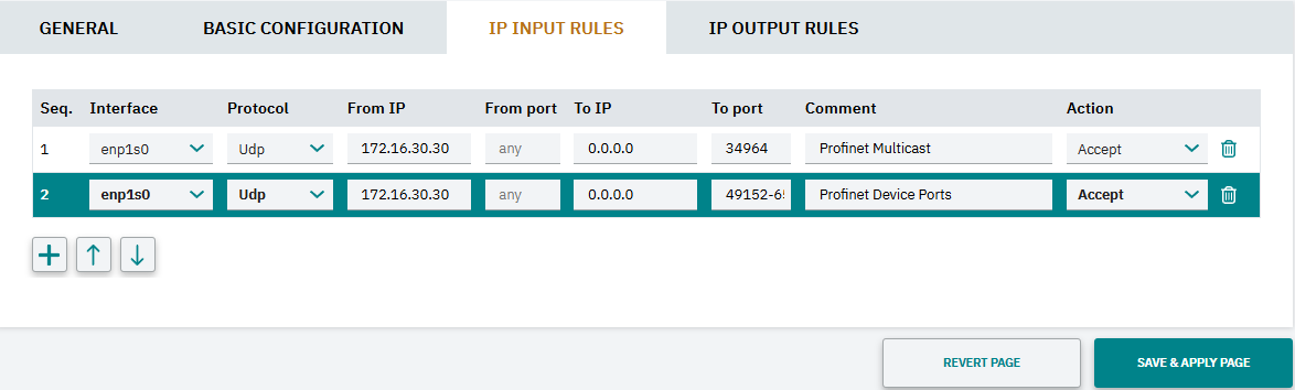

  • On the IP INPUT RULES tab, add another new rule via the .
    • Select the interface.
    • Enter the IP address range.
    • Enter a target port (here: 49152-65535).

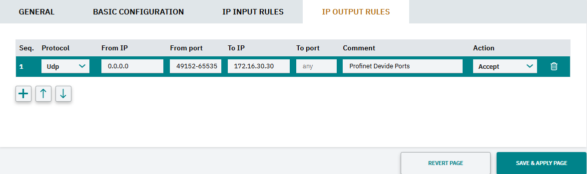

Output rules
  • Open the IP OUTPUT RULES tab.
    • Enter a port (here: 49152-65535).
Note: To make sure that all newly applied input and output rules are actively used (even for connections that have already been established), restart the PLCnext Control.
