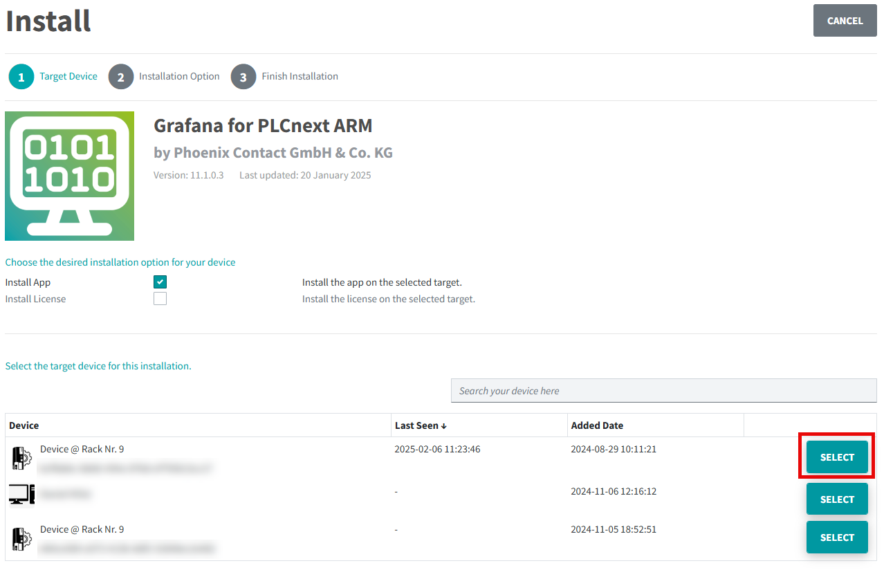

- Select the target device on which you want to install the function extension.

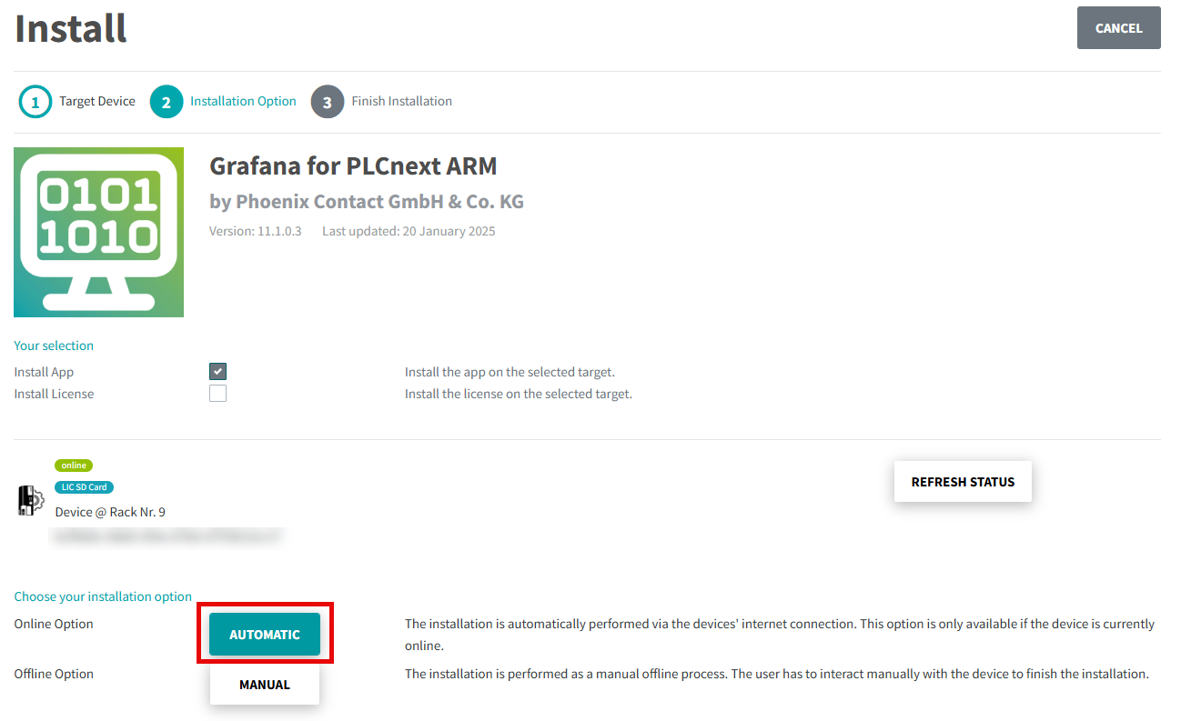

- Choose the installation option for your device.

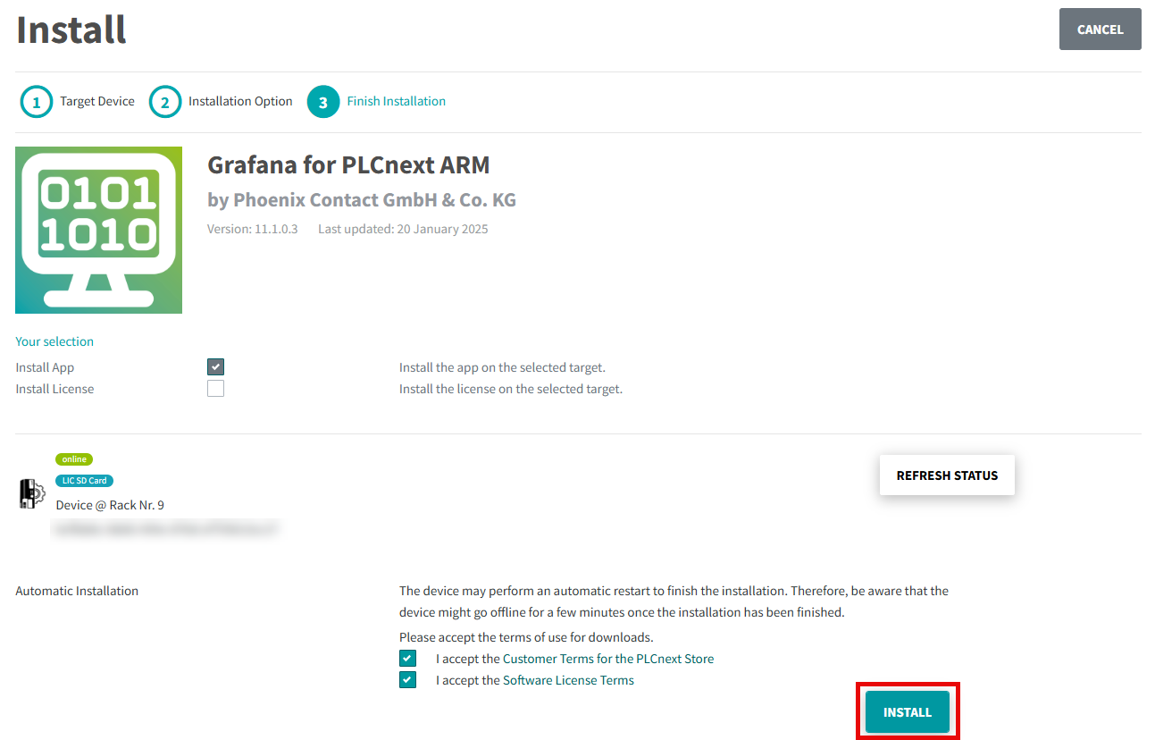

- Read and accept the Customer Terms for the PLCnext Store as well as the Software License Terms ("Terms & Conditions").
Click the button.
The function extension will be installed on the device.
