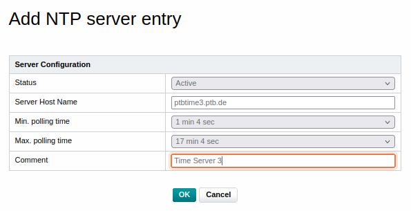

  • To add a new server entry, click on  at the left bottom of the table.
The Add NTP Server entry window opens.
  • Enter the new NTP server configuration.
  • Click OK to add the new NTP server entry to the list.
The new entry is now available in the NTP Client Configuration table.
