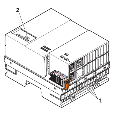

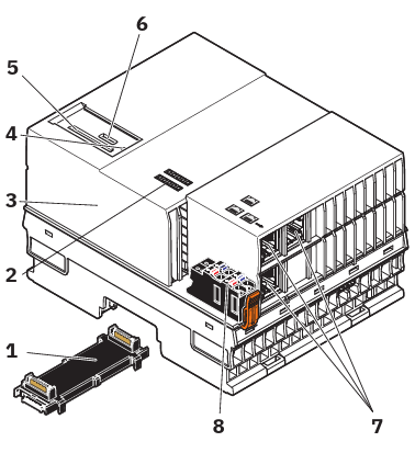

The controller consists of the following components:
SD card
  • Only use encrypted SD cards!
Information on this can be found in the topic SD card encryption.

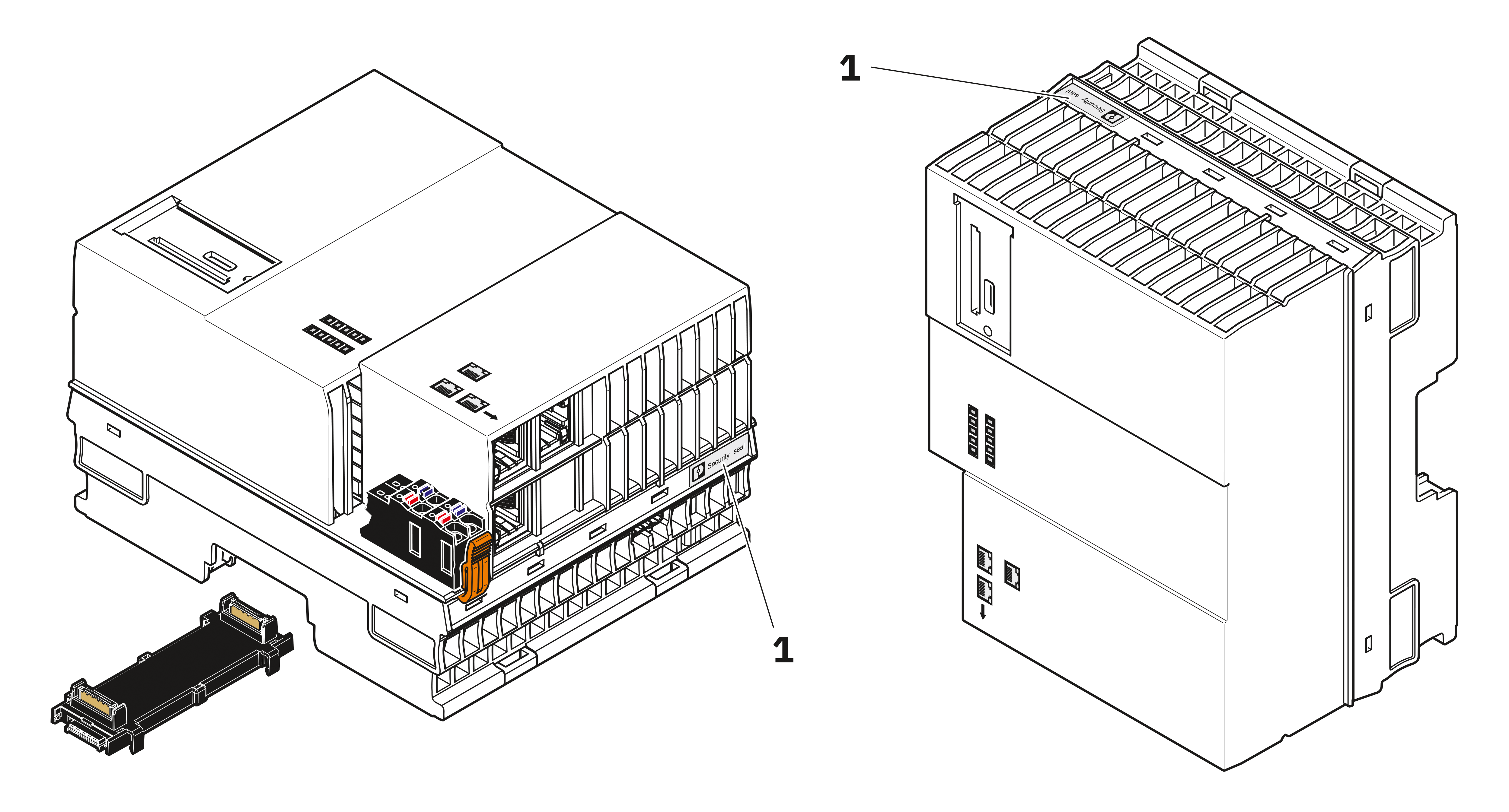

Security seals
In order to prevent manipulation of the device supplied and to detect unauthorized opening of the device, security seals have been applied to the controller.
From hardware revision 04, the housing of PLCnext Control AXC F 3152 is protected by security seals like shown below.
These security seals are damaged in the event of unauthorized opening. In this case, correct operation of the PLCnext Control can no longer be ensured.
  • Check the delivery for transport damage. Damaged packaging is an indicator of potential damage to the device that may have occurred during transport. This could result in a malfunction.
  • Do not open the housing. If the housing is opened, the function of the device can no longer be ensured.
  • Check at regular intervals that none of the seals are damaged. If any of the seals are damaged or missing, it may be that the device has been tampered. In this case, contact Phoenix Contact without delay before using the device.
Security seals

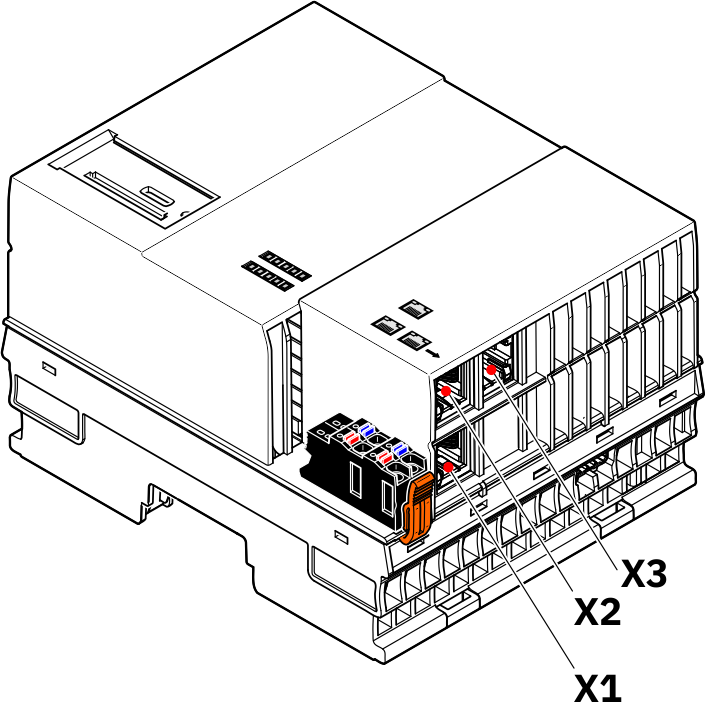

Ethernet interfaces
The Ethernet interfaces are assigned as follows:
Assignment of the Ethernet interfaces
The following is an overview of how the Ethernet interfaces are assigned on the various pages in the WBM
Ethernet interface hardware Ethernet interface WBM - Network page Ethernet interfaces WBM - Firewall page
X1 TCP/IP (LAN1) LAN1
X2 TCP/IP (LAN2) LAN2
X3 TCP/IP (LAN3) LAN3

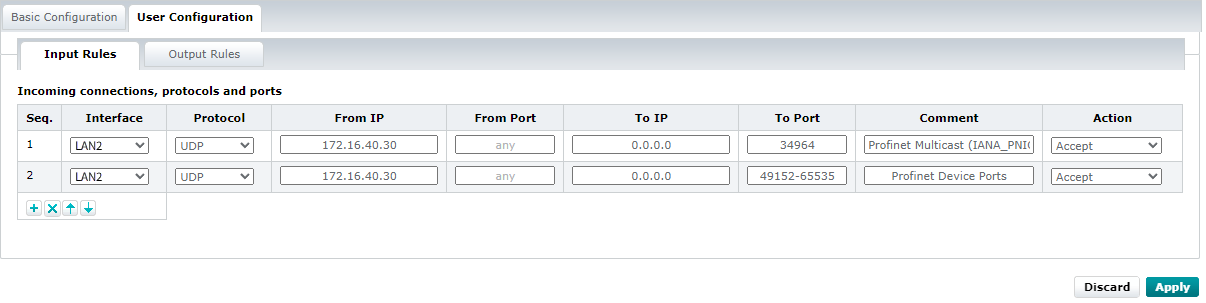

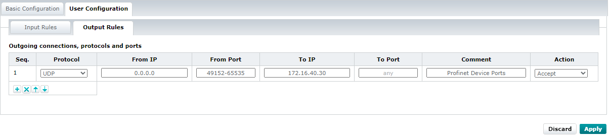

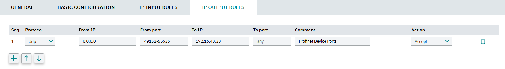

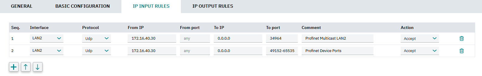

Firewall configurations
You need to adjust the firewall configurations (for more information, refer to the firewall basic configurations ):
Input rules:
Output rules:

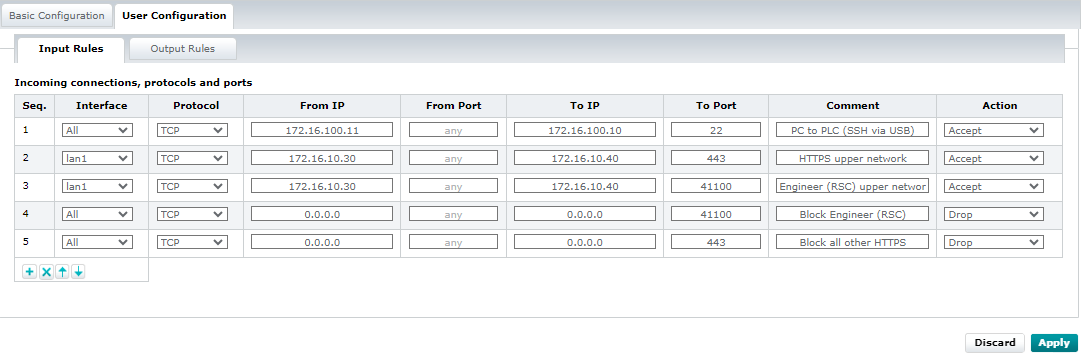

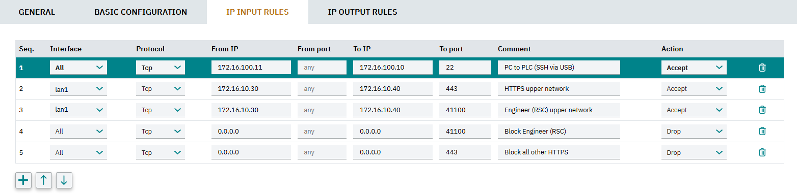

Using the service interface (USB)
  • Perform a threat analysis before activating the service interface.
You should only use an SSH connection during commissioning, not during operation of a system.
Note: You must always explicitly deactivate the service interface. It is not deactivated by a reset 1/reset 2 or activating the Security Profile. Once activated, the service interface will otherwise always remain on.
Here is an example of the firewall settings you need to make when using the service interface (see comments in the following screenshot):
