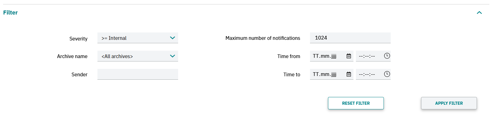

  • On top of the table users can open a section with several filter options for the listed notifications by clicking the   triangle in the upper-right corner 5. For details, refer to the Filtering notifications section.
↓ Notifications page - default view
Notifications page - table view
Filter options can be applied in parallel or exclusively. At least the maximum number filter is always active.
Note: When editing or adding more filter criteria, the table is reorganized once you click the APPLY FILTER button.
↓ Notifications page - unfolded filter section
Notifications page
Filtering by severity
For filtering, a cut-off is set, meaning higher levels are included when filtering by a lower level:
  • Filtering on >=Internal displays all notifications because all other security levels are higher.
  • Filtering on >=Information displays notifications from severity levels Information, Warning, Error, Critical Error, and Fatal Error.
  • Filtering on >=Warning displays notifications from severity levels Warning, Error, Critical Error, and Fatal Error.
  • Filtering on >=Error displays notifications from severity levels Error, Critical Error, and Fatal Error.
  • Filtering on >=Critical Error displays notifications from severity levels Critical Error and Fatal Error.
  • Filtering on Fatal Error displays notifications only from severity level Fatal Error because all other security levels are lower.
Filtering by archive name
You can filter notifications by their archive name. You have the following setting options:
  • <All archives> shows notifications from every archive.
  • Selecting one archive name shows notifications from just the selected archive.
Filtering by sender
You can filter notifications by their sender name. Already applied filters form the basis for the Sender drop-down menu: Only the sender names of the notifications already listed in the table are displayed in the Sender drop-down menu.
You have the following options:
  • Select a sender name from the drop-down menu. The listed sender names correspond to the names in the notifications table.
  • Enter a sender name or a part of a sender name in the input field. Use this option if the sender name has not yet been listed in the notifications table.
    Filtering displays notifications from senders that match (or partially match) the search term you entered.
Filtering by restricting the maximum number of notifications
You can enter the maximum number of notifications to be displayed, regardless of other filter criteria. The default setting is 1024, and the maximum number cannot exceed 4000.
Filtering by timestamp
You can limit the time period for which notifications are displayed by filling in the input fields Time from and/or Time to. When using this filter, entering a date is mandatory; specifying a time is optional. Therefore, if only a time is entered, the date is always set to the current day which then can be edited.
  • Time from set: Notifications that are not older than the specified date (and time) are displayed.
  • Time to set: Notifications that are not newer than the specified (and time) are displayed.

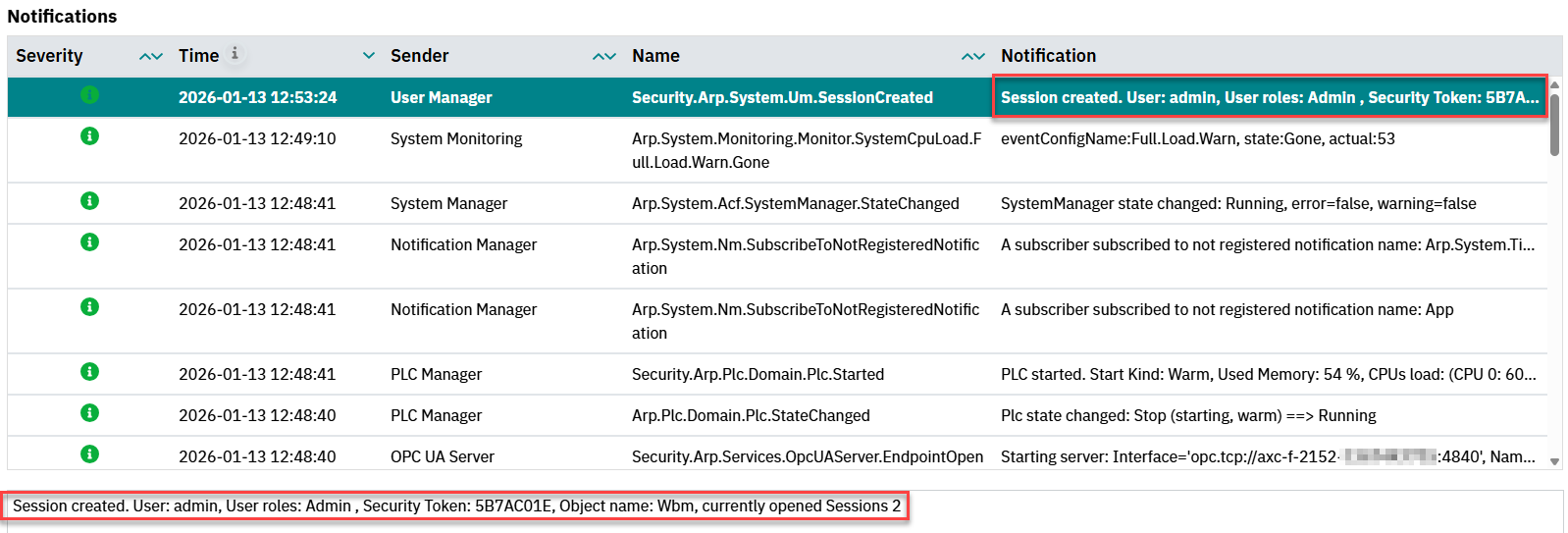

Security logging
For secure operation, user actions in the WBM 2 are logged when working with an active Security Profile (on devices of the first PLCnext Control generation) and always on Secure-by-default devices (e. g., AXC F 1252).
Each session in the WBM 2 is registered under a specific Security Token. The notifications of the User Manager (UM) show the user name and user role along with a unique Security Token for each session.
↓ Notifications page - visible Security Token
