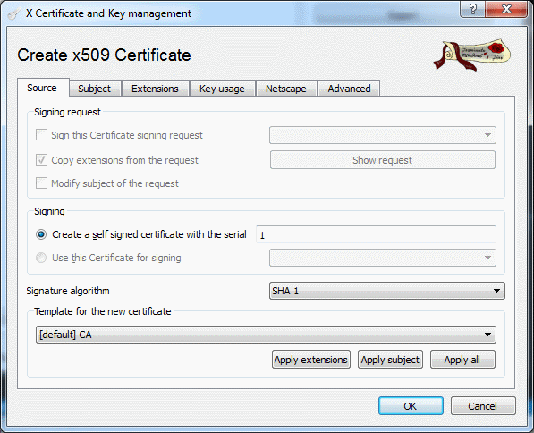

On the source tab select default CA, and on the subject tab:
Figure 2: Source configuration / default CA

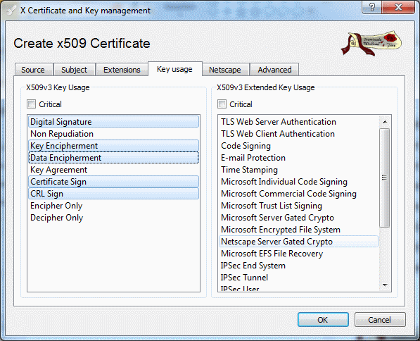

The Key usage tab will also need some settings:
Figure 5: Key usage configuration / default CA
Select:
  • Digital Signature
  • Key Encipherment
  • Data Encipherment
  • Certificate Sign
  • CRL Sign
