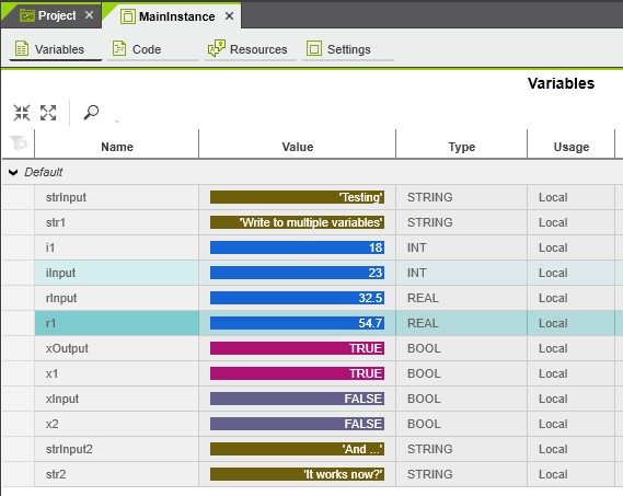

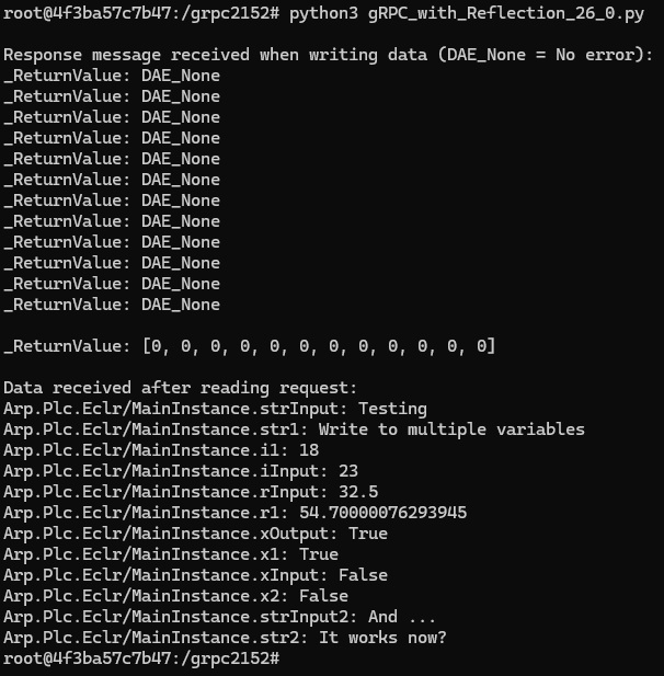

  1. Download and start the PLCnext Engineer project "TestingGRPC.pcwex" from the github repository.
  2. Test the grpc functionality from the console of the container by executing the script "gRPC_with_Reflection_26_0.py". In debug mode, the content of the variables should be populated with the text values from the script and also displayed on the console after being read from the PLCnext Engineer project.
